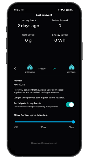

1) Select the Kasa widget from the 'Home' tab of the equiwatt app
EQ App Screens (2)
2) Select 'Remove Kasa account' at the bottom of the screen

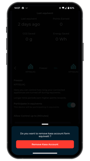

EQ App Screens3) Select the red button to confirm the removal of your Kasa account from the equiwatt app.
EQ App Screens (1)
4) Reconnect your Kasa account to equiwatt to see if this resolves your issue.
