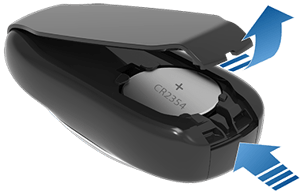

Replacing the Key Fob Battery
Under normal use, the key fob has a battery that lasts for up to one year, depending on the key fob version and selected vehicle settings. When the battery is low, a message displays on the touchscreen.
To replace the key fob battery:
1) With the key fob placed button side down on a soft surface, release the bottom cover, using a small flat-bladed tool.
PLEASE NOTE: If a lanyard is attached to the key, you can release the bottom cover by placing your thumb against the "X" on the bottom cover, then firmly pulling the lanyard toward you (hence pushing the key off of its cover). You can also pry the cover off by placing a small flat-bladed tool, a fingernail, or the Tesla-provided tool against the lanyard cord.
2) Remove the battery by lifting it away from the retaining clips.
3) While avoiding touching the battery's flat surfaces, insert the new battery (type CR2354) with the ‘+’ side facing up.
PLEASE NOTE: Wipe the battery clean before fitting and avoid touching the battery's flat surfaces. Finger marks on the flat surfaces of the battery can reduce battery life.
CAUTION: The battery should press against the spring on the positive contact. Do not place the battery on top of the contact and force it down vertically. Doing so may damage the contact.
PLEASE NOTE: CR2354 batteries can be purchased from any retailer that sells batteries.
4) Holding the bottom cover at an angle, align the tabs on the cover with the corresponding slots on the key fob, then press the cover firmly onto the key fob until it snaps into place.
5) Test that the key fob works by unlocking and locking Model X.
